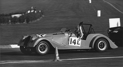

Hi Jochem,
Mary posted a picture of one of the "Tupperware" Morgans in a Topic on the Birkett race.
The fountain of obscure knowledge (Mark Shears) added the following detail:
Alan Kennedy - 4/4 Lightweight Special
Alan built 2 of these Lightweights one Gold and one in Blue, Morgan chassis but fibreglass bodies and no ash frame, I saw one for sale a while back but who has them now ? One is being sprinted by Mike Hughes
Hope this helps
Tim
Hope this helps
Tim
