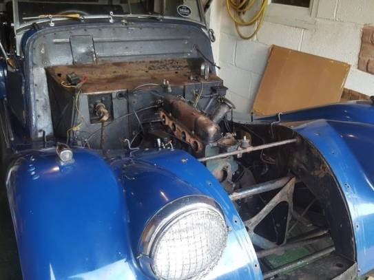

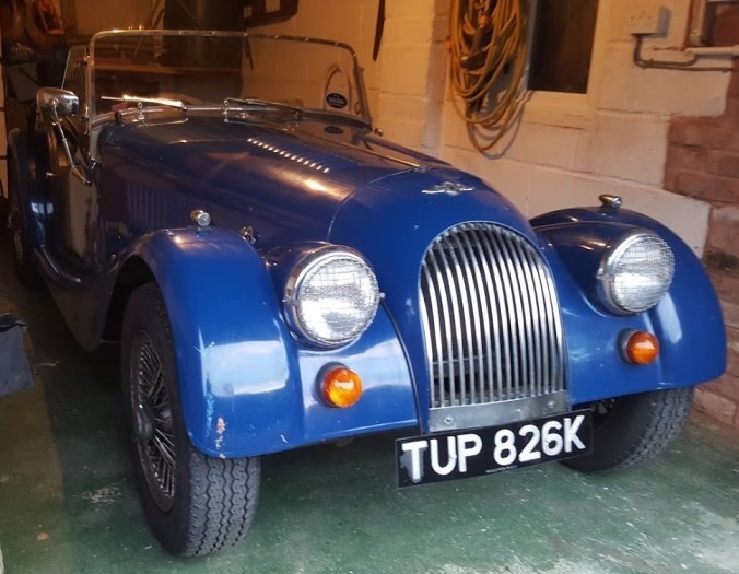

I a restoring this 1972 4-seater Morgan
The car is currently very much in parts with some repair work about to begin on the body. Soon I will upload some images of the restoration in case anyone who knows this car from the past is interested.

Please see first images of TUP restoration project - many more to come
